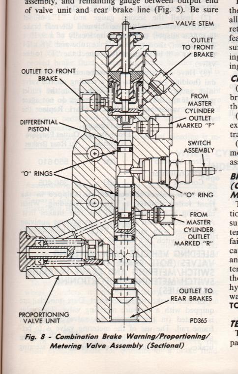

but back to the discussion, There is alot of shitty information out on how the valves work.... and i want to know whats true and whats not.
the removing the oring trick..... lots of misleading info out there saying it makes it 50/50. but we r saying that it is a residual valve and just keeping pressure in the rear brake lines. How exactly does this work? by looking at this picture:
one would think that the section on the front where the o ring comes out would be the proportioning section...... WHAT IS THIS O RING DOING? How does its work? I dont have a combo valve sitting infront of me and im not running out to take mine apart to understand it.Originally posted by Ktmracer419some people choose video games
some choose projects
some choose welding random things together
looking at this picture fluid flows past the differential piston (shuttle valve), then flows into the proprtioing valve (which resembles the front section of a xj combo valve). correct? so does the xj combo valve indeed include a proportioning valve? where is the o ring located?Originally posted by Ktmracer419some people choose video games

I'd need better pictures or parts in hand.
What I remember is that it is only a check valve.
The o-ring is a lip seal so only prevents fluid from coming from the wheel cylinders back to the master. and lets the fluid from the master flow freely to the wheel cylinder.
But it has been a while.
I think this guy has the lip seal back words, it doesn't make sense that way but I would like to see an XJ cross section.
http://www.lunghd.com/Tech_Articles/..._Valve_Mod.htm
Like I said it has been a while.
Either way I would remove the ring and install an adjustable prop valve as needed they are only $30RCrocs #123 Brown CJ-5

Yes, i was looking around and finally found a decent photo of it... i do believe this is just a check valve and the oring is just the seal.... so basically the piston and spring can be removed aswell and it would do the same. i might have one laying around the garage to see in person.Originally posted by customcreationsllc View PostI'd need better pictures or parts in hand.
and yes i do agree with the the adjustable prop valve... did that with rear disc swap on a yota.Originally posted by Ktmracer419some people choose video games
Originally posted by justtorchit View PostYes, i was looking around and finally found a decent photo of it... i do believe this is just a check valve and the oring is just the seal.... so basically the piston and spring can be removed aswell and it would do the same. i might have one laying around the garage to see in person.
You cannot just remove the piston and spring I tried that there is another seal on the shaft if it is not in there brake fluid just comes out the hole.RCrocs #123 Brown CJ-5
