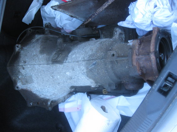

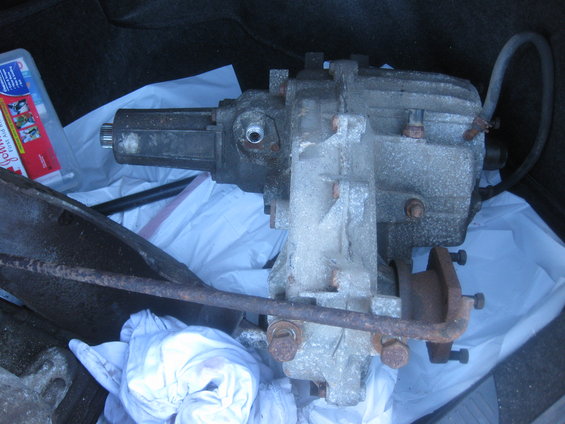

                  Picked up the tranny and t-case from GM truck heaven today.
                  Tranny came with torque converter and lower cover, so thats some money I can spend elsewhere. Still need to get the SYE and clocking ring for the 241. All together, the motor, tranny, and t-case cost me 700 bucks...not too bad.
