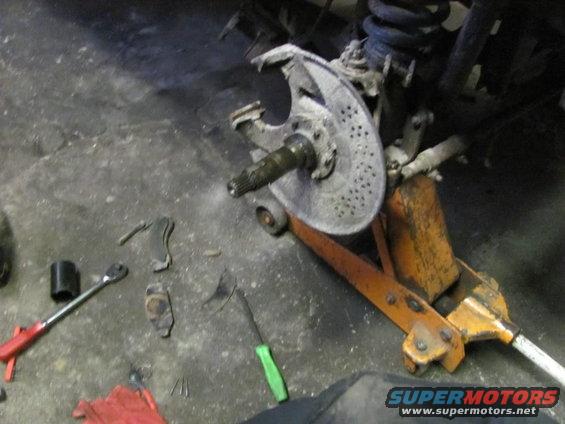

      Front end in the air
      Removed the hub, caliper and rotor

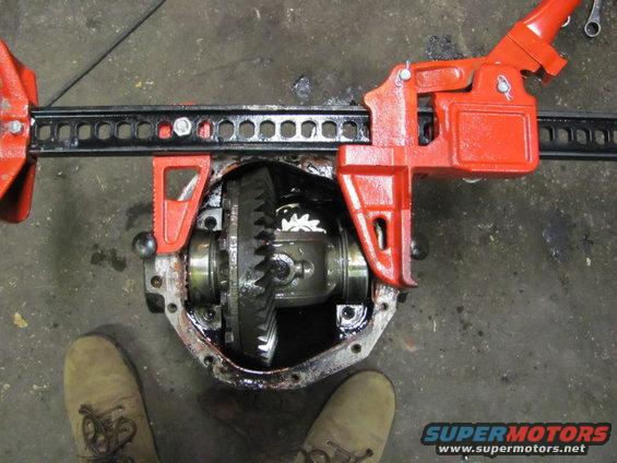

      And because the dana 44 requires a case spreader and I didn't have one at the time I figured out a way to use a hi lift and some bolts to spread the case.

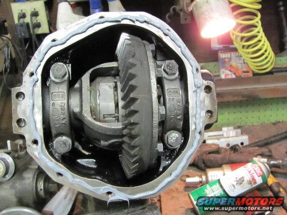

      Next place the outer pieces of the locker in the carrier
      Then you have to make sure all of your gaps are correct and place the rest of the locker in the carrier.
      Then place the carrier back in the 3rd member you can do this by lightly tapping it with a rubber mallet or dead blow mallet. Also don't forget to seal it up with either a gasket or some RTV.
