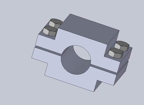

                    If Phil can machine the two halves of this clamp I whipped up for you and drill and tap (4) 1/2 -13 holes, you can bolt this around the tube and weld the vertical support directly to it.
                      that looks like it would be no problem for phil at all, thanks man
                      only problem i forsee him having is boring a hole 1.75" big, but he'll chime in when hes home im sure
                        The clamp is the easy part, I just need the materials. 1/2-16 or 5/8 coarse bolts will work just fine.

                              Also, the 2" hole wouldn't be a problem, for a clamp like that you chuck the entire piece into the lathe and bore the hole with tool bits instead of drills. The bigger the hole, the easier, especially when making a clamp from a solid block.
                              Problem is with most of our projects is that there isn't a center and finding it with a 4 jaw chuck would take too much time.
