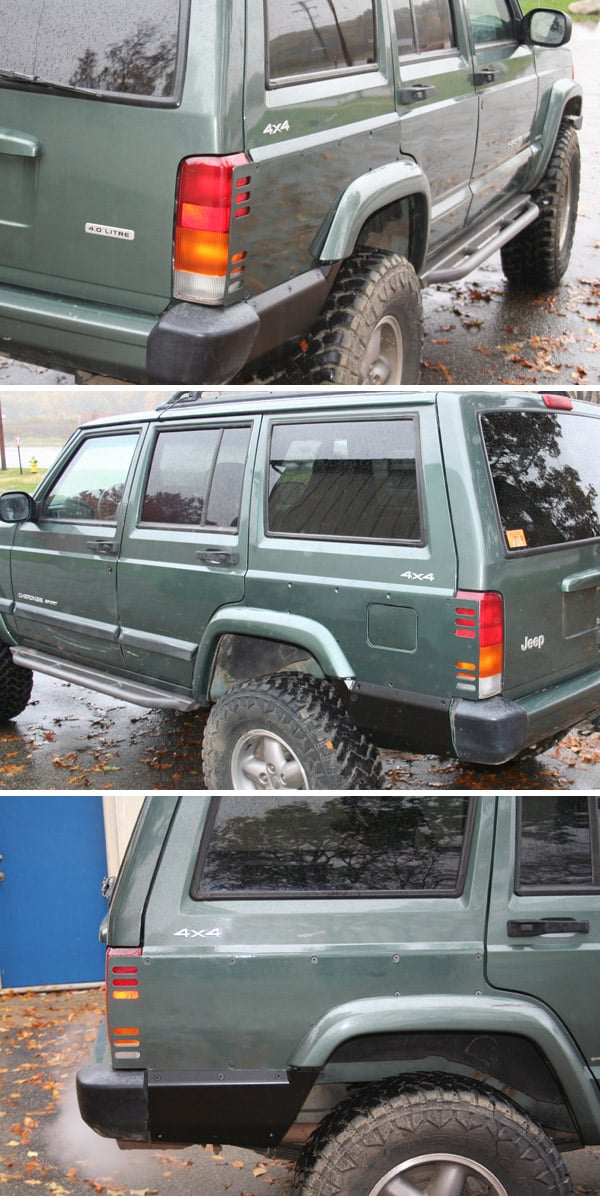

    A few days later I sideswiped some tress and broke the flares and bumper endcaps off. The paint was really scratched so I decided to paint it flat tan. While I was at I bought some Bushwackers and trimmed the fenders.
    Before
    After
