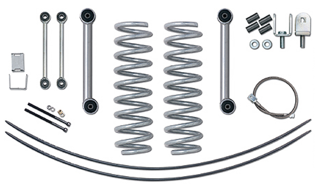

    so seeing as how you can do a combined suspension/body lift with an XJ im thinking of doing something similar...
    so as it sits right now i have this:
    Rubicon Express 3.5" Super Ride AAL (which isnt so super)
    im thinking of adding a 1" to 2" budget lift to that (shackles not lift blocks) and coil spacers. my question(s) would be....is this even useful or is it kinda silly? and also without adjustable control arms etc would the RE kit that i have right now even handle that. I only ask because i have a tight budget and theres no way im gonna spend upwards of 600 bucks right now for a true 6" kit etc.
