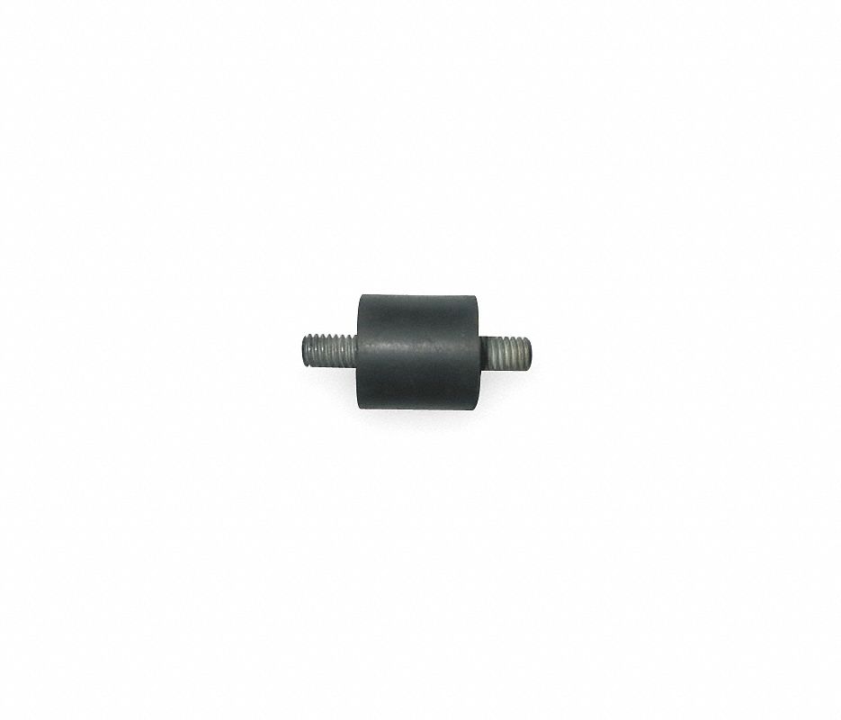

    I have mounted hundreds of gopros to hundreds of race cars over the years and have never once seen that effect. That has to be some serious tight strong vibration. I would isolate with thick rubber and see where it gets you. I am guessing its mounted directly to a mount that is welded to the frame?
      yes I made a metal mount and bolted it right to the frame.
      I picked up some rubber dampeners and see hot that works.
